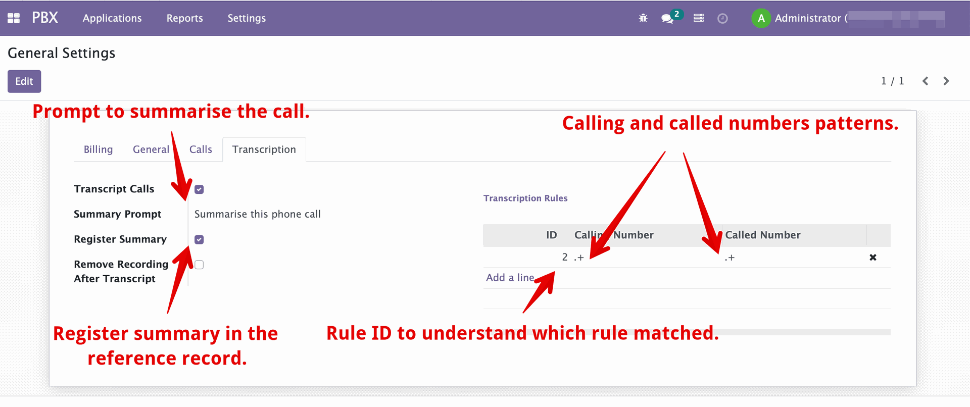

AI call transcription and summary
Activate and configure
PBX → Settings:
  • Set Summary prompt (write the instructions in your language).
  • Enable Register summary to post summaries on partner/reference records.
  • Define Calling / Called number patterns (Python regex) to control which calls are sent (API is billed).
Settings Example patterns:
  • .+ — all numbers
  • ^100.+$ — numbers starting with 100
  • ^.+90$ — numbers ending with 90
  • ^1234567890$ — exact number

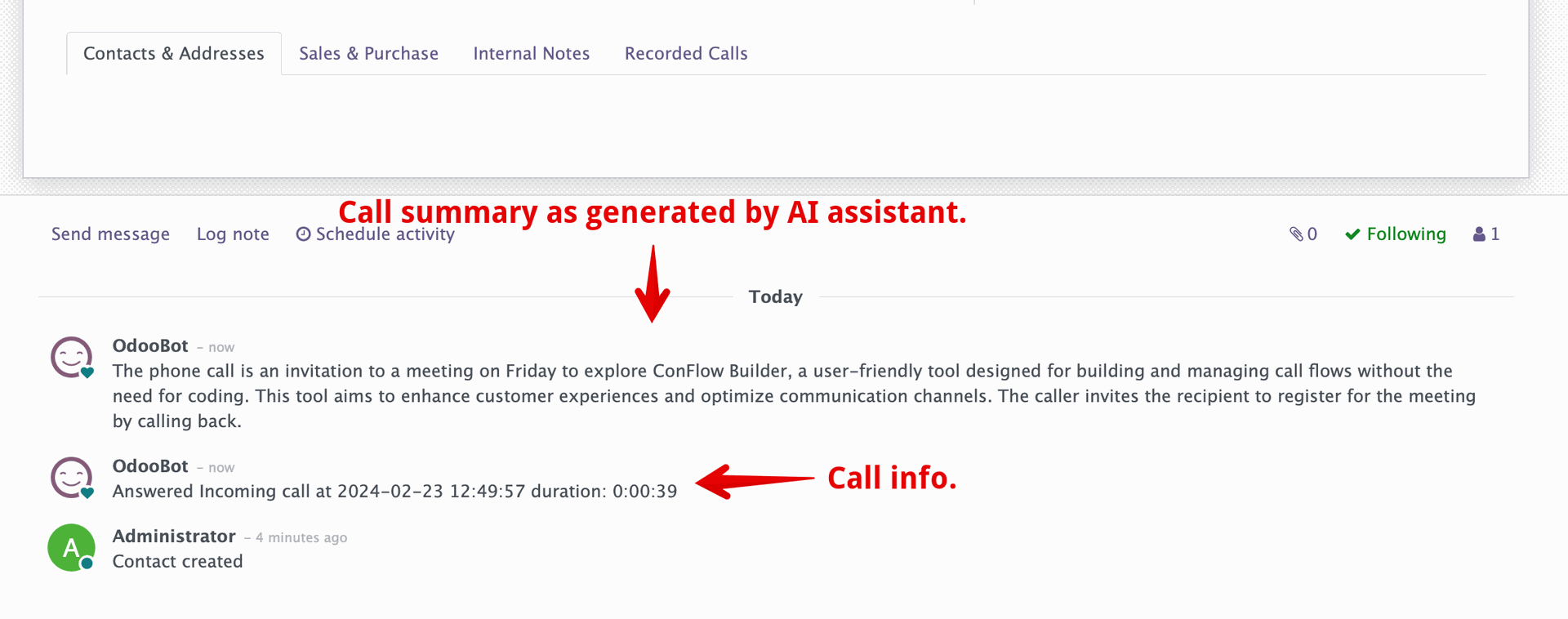

Example summary posted on the partner: Summary posted
